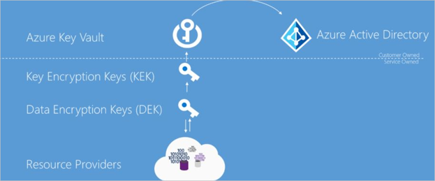

It is important to understand some of the key components involved in providing the at-rest data encryption available in Azure.
azure-security-encryption-atrest-fig1
Source: Azure
  • Azure Resource Providers: A service that supplies Azure resources and services. Examples include Microsoft.Compute, which supplies virtual machine resources, and Microsoft.Storage, which supplies storage resources such as storage accounts and blob storage.
    These resource providers perform the encryption and decryption of data, typically using a data encryption key, which is generated using the root key encryption key (KEK). Azure encryption at rest options for various services cover its Infrastructure-as-a-Service components (i.e., Azure Virtual Machines, Storage accounts), Platform-as-a-Service components (i.e., Azure SQL databases, Azure Cosmos DB), and Software-as-a-Service components (i.e., such as parts of Office 365).
  • Data Encryption Key (DEK): In Azure encryption, symmetric encryption keys—which are referred to as data encryption keys (DEK)—are used to encrypt (and decrypt) data. Azure resource providers, described above, or the application instances needing to encrypt or decrypt data in Azure need access to the DEK in order to do so. This is a system key that is generated automatically using the root KEK and users have no control over the DEK itself directly.
  • Key Encryption Key (KEK): KEKs are encryption keys that provide an additional level of security by encrypting the DEK itself. KEKs are also known as root keys.
  • Azure Key Vault: For added security, encryption keys themselves need to be stored in a secure location that is separate from the data. It’s recommended by Azure to use Azure Key Vault as your key storage solution in the Azure cloud.
    Azure Key Vault provides the services typically offered by a hardware security module (HSM) in an on-premises environment for encryption. It provides the access controls needed to secure the access to the encryption keys to end users (authenticated via Azure AD accounts) as well as Azure services.
